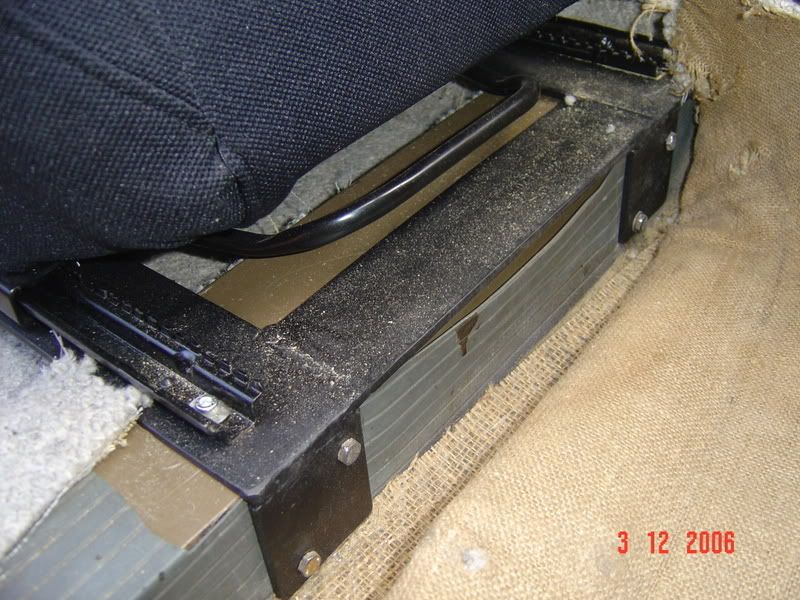

I made my own brackets for a Cobra Trophy from 30mmx2.0 and 25x1.5 SHS tube. All the welding is nickel bronze... 8)
The front bolts into the Mini 3 hole brackets.
The rear crosstube is angled so it sits flat on the floor.
It's quite stable on track days but if I was really racing I would bolt the rear through the floor. :wink:

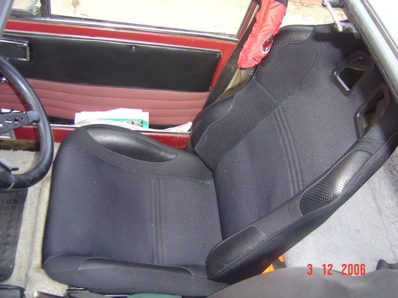

mtsmini wrote:
Tombo wrote:

thanks for those pictures, now i know exactly how to mount it, but does the seat sit high.
Sav

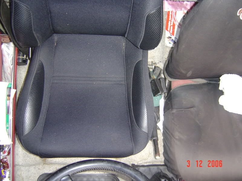

my seat sits about the same
mtsmini wrote:
Tombo wrote:

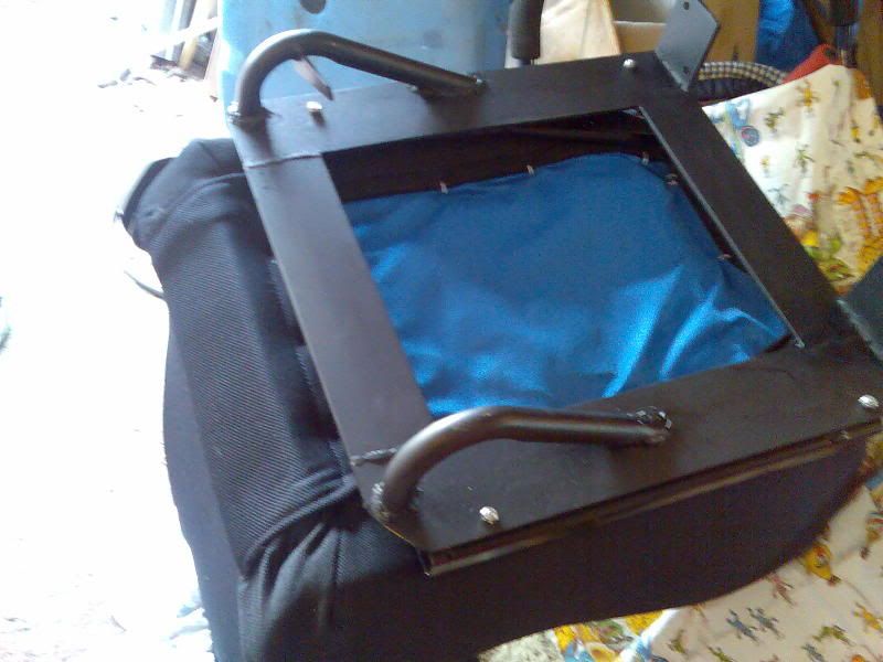

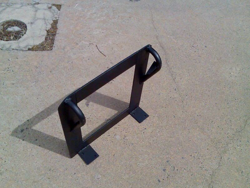

Two alloy brackets, thus:
Front one:
Rear one:
