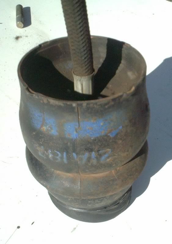

PostPosted: Wed May 07, 2008 10:41 am
Posts: 637
Just to add another type.
Here are the blue Cooper S displacers from a 1966 Australian S.
My 1968 S had silver displacers with (from memory) twin silver bands on the displacers as well as the hoses. The rears had single silver banding.

Thanks Wild willy and 1100 for your replies and photos. Wild willy, are yours 5/8"? They look like they might be.
It is starting to look like British ones might be 1" across the range, it's only the Aussie made Cooper S ones are 5/8". Does everybody agree with my assumption?

PostPosted: Wed May 07, 2008 5:56 pm
66S wrote:
Hi guys
Thanks again
Al
No. Only one of mine is Australian made. The other three are UK made. So I have both Aussie and UK that are 5/8"
The part numbers are a clue to the place of manufacture. Australian made parts will have a "Y" in the part number.
From the 1969 BMC parts book I have the following numbers...
Rear displacers.
AYA4090 (Australian part number)
21A2010 Double Orange band.
21A2014 Double Blue Band
Front Displacers.
21A1477 Deluxe.
AYA4090 Deluxe, 1 Orange Band. (Australian part number)
21A2010 Cooper S, 1 Blue Band. (YKG2S2-1918 to 3716)
AYG4113 Cooper S (From YKG2S2-3717) (Australian part number)
