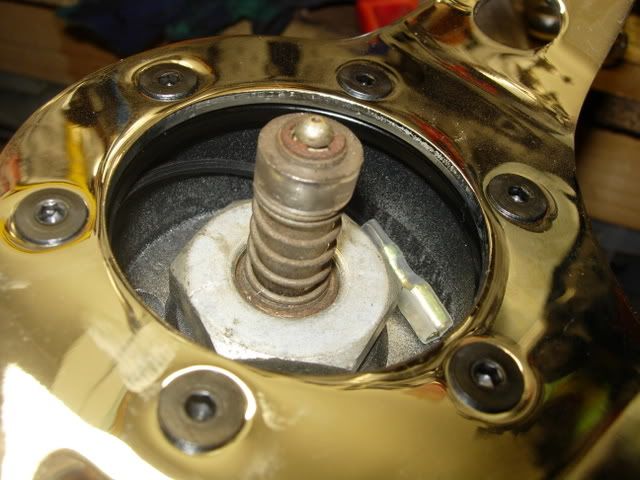

My 65 has this original horn push button thing:
It is too high for the replacement wheel and horn push. As Mick says - take off the circlip, remove spring and connect wire at button to horn button. Earth is through the brass slip ring. Does that make sense?
Oh yeah and keep all the bits so you can put the original wheel back on!
