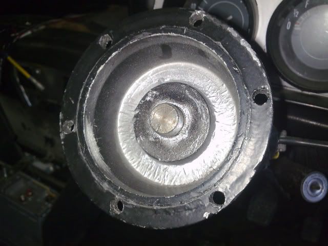

So my old wheel was looking pretty old and tired, so I got myself a pretty new steering wheel.
I brought it home, removed the old wheel easily enough, and cracked open the centre to expose the centre bolt, which also came off easy enough...and now I'm stuck! For the life of my I can't get the old boss/mount off the steering column. Am I missing something? Could I be facing the scary prospect that the previous owner has attached the mount with glue? Here's a pic as to where I am now, please help!

You need to use a Puller. Wind the nut back on, then use the puller to release the boss. The reason you put the nut back on just a little bit is so the boss doesn't pop of and hit you in the face.

Or wack your old wheel back onto the boss, crack the nut but leave it wound on the thread a few turns. Get your knees under the bottom of the wheel and grab the top sides of the wheel, then pull towards yourself and push with your knees. It will go "pop"when it releases. MAKE SURE YOU HAVE THE NUT ON THERE!!!!!
PostPosted: Sat May 24, 2008 6:06 pm
block of wood and a hammer from underneath might work too ;)

Tap the back of the boss with a hammer - I've done it before and after a couple of blows it came off - I suggest doing what every one else has recommended and leaving the nut on there a few turns.

A trick that I was taught when I was working in a wrecking yard was to loosten the nut and thump downwards on the outer rim of the steering wheel. You just slap down on both sides in sequence just like bashing the bongo drums. :shock:
It sounds all wrong but it works. I never used a puller on a steering wheel after I learned that trick. :D
Now because this one is just the aluminum boss I would just get the heat gun onto the boss to expand it loose.

A trick that I was taught when I was working in a wrecking yard was to loosten the nut but dont remove it and thump downwards on the outer rim of the steering wheel. You just slap down on both sides in sequence just like bashing the bongo drums. :shock:
It soulds all wrong but it works. I never used a puller on a steering wheel after I learned that trick. :D
Then when pulling towards you wiggle the s/wheel side to side with some force and it should come off the splines quite easily. Also a sqirt of wd40, rp7, inox, etc where the splines are in the centre of the boss may help too.
