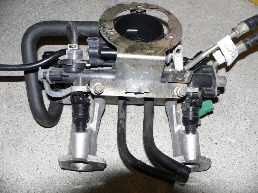

For the MPI's manifold look here:
http://www.ausmini.com/forums/viewtopic.php?t=42575
And here:
http://666kb.com/i/az5rxbg5odcl5bzam.jpg

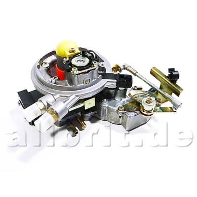

The SPI's manifold is this one:

This pic is the best from Ashpalt's links
My only comment is that 2 injectors is not enough for an engine that is going to rev.
