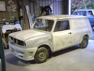

I do have them on my van, a lot of work and like sports said their is 2 ways.
The first way is the way I did it, you end up with oz doors and internal hinges. By oz doors I mean you still have the 1/4 window and the roll up window.
The 2nd way of installing the entire Rover door frame may be harder as your cutting a lot of the car out (1/2 the A pillar, 1/2 the B pillar and the top and bottom of the door frame all in one piece, but then all parts are easily obtainable unlike my doors which are custom made :roll: .
On mine the A pillar from the bottom of the window line down to the floor pan is all Rover, from memory the hinge panel is also Rover, also the front 2 inches or so of the door is Rover aswell. You'll see that the bottom of my doors are square like the Rover doors as that was the easiest way to do it.
