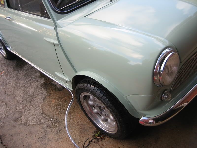

As said, the extension strip are usu. welded 'over' the lip. But my extension are welded side-to-side to the lip. This isn't what most people do right?
Also is Sikaflex between guard and flares what most people do? I was thinking if there are actually gaskets that go between the guard and the flare?
This is how mine looks like
