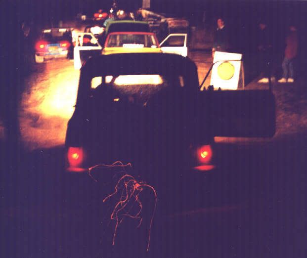

Like this?
Pretty sure it was just carbon flaking off the lukey when it got hot.
Set fire to the grass on the previous stage of the rally :oops:

Tspeed Jem wrote:
Like this?
Ha! I remember that. Didn't realise that you had photos. Cool! :D
