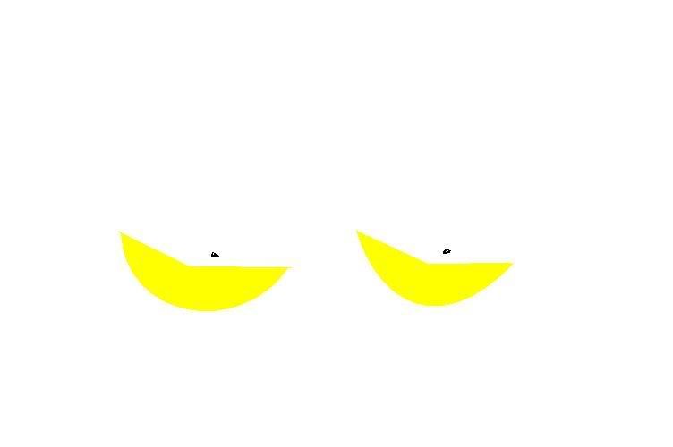

Park against the wall, put two small bits of tape on where the lights would touch. Reverse 5 meters, and try to get this sort of approach.
Has worked for me many times. I found it in a Gregory's manual.
