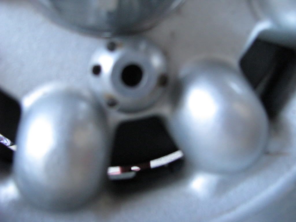

hey i have some roh contessas and was wondering; is this a locking wheel nut?? how can i get it off without a key?

Yes it is a lock nut , unless you can find someone with the exact same one your best option is to use a small cold chisel or punch and tap the lock nut around to unscrew it .

If that doesn't work I would get a grinder and grind a couple of flats onto the nut so that you can stick a pair of long handled pliers on it, or even grind a hex nut onto it and then stick a socket onto it (use one of the other nuts ot get a general outline of how big the hex nut should be :wink:

That type was on the sports850 when I first bought it and the previous owners couldn't find the key , only took about a minute each wheel to get them off (they aren't really very secure...) with a cold chisel and little to medium taps with a hammer . Don't belt the bejeezurs out of it , just tap tap tap till it starts moving .

Undo the lock nut with the chisel method before you loosen any of the others.
It will be much easier if you take the three "normal" nuts off afterwards.

i tried the chisel method however that didnt work. and im not a very good welder. so now i will get a local mechanic to give me a hand tommorow. thanks for all your help.

I use to have the same issue with my Alfa. I smacked a socket onto it till it made its on impression. I did have to use a braker bar also but they all came off. The tip is also as mentioned above is to do it first and leave the others till you have the lock nut off.

Before going to a mechanic you could try this method.
1. Jack the wheel up clear of the ground.
2. Undo the 3 standard nuts and remove them completley.
3. Have someone hold the brake on.
4. Grab hold of the wheel and turn it in an anti clockwise direction.
You will get a small amount of movement with the clearance on the other 3 studs that should be enough to loosen that pesky locking nut. Move it back and forth if you have to.
Hope this makes sence to you.

i went down to local mechanic and they were going to charge $77 per hour, reluctantly i booked them in the next morning. after showing them a picture of the type of nut the night before, the bloke turned up with a socket and a breaker bar. :x
thankyou for all your help.
oh and sports that method of the punch worked well.
