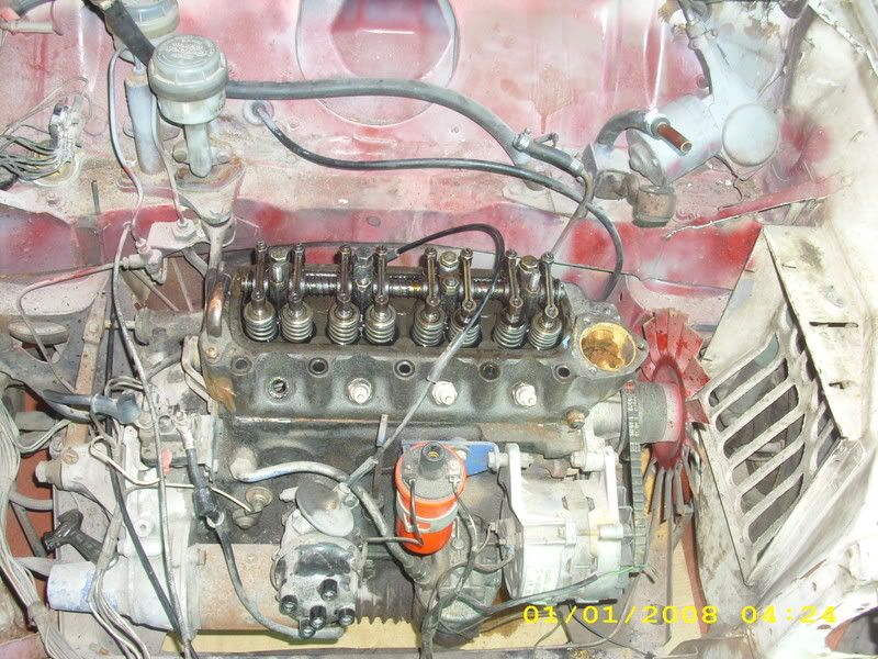

Hi guys,
just need some help identifying one of my engines that came out of a 71 clubman.
Markings on the gearbox are = M/4973
There is also a little silver tag that says 1000 on it (998cc? ) and across from that is...
12a
497
Markings on the head are = 9F/SA/L/28609
anyhelp would be greatly appreciated. :)

I think (someone else will confirm) that it's a 997 cooper engine .

Thanks sports, if it helps.. it also came with twin su's :?

probly definately a cooper 997 engine now :lol:

so if i was to buy an engine rebuild kit from minisport, id go for the 1000cc kit, yes?
PostPosted: Tue Oct 07, 2008 11:35 am
Not sure what comes in the engine kit but a 997 engine is different bore and stroke to a 998 , bearing's could be different too . best to wait till you have confirmation of the engine size (including head off and measure bores since numbers can be changed) and talk to the suppliers .

Im restoring a 75 clubman, no idea what motor it has though, by the looks of it its also a 997.

This engine number would have been in a 997 cooper, they had a longer stroke than the 998 and had a nasty habit of throwing a leg out of bed ( con rod out through the side of the block.. Usually the back of the motor)

Number corresponds to a 997 Cooper, but as John Says, you would have to measure the bore and stroke to confirm.
N.B. The number is on the block, not the head.
Does this block have a manual fuel pump hole on the back? :?
