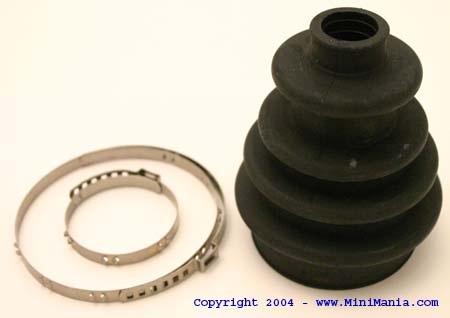

The metal clip that comes with some Boot Kits.
Like these ones form Mini Mania http://www.minimania.com/web/Item/GSV1053/InvDetail.cfm

I have one of these straps and it still comes off.
I have to try again, does anyone sell them seperate?
