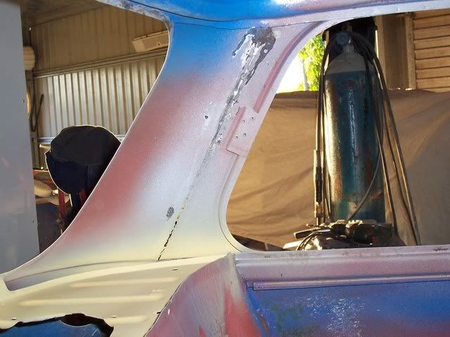

It depends if the Rover shell has the correct inner panel on the C pillar. If it dose it will be easy as, just drill some holes and screw it in (and you'll need some window rubbers).
This is the panel you need; the one with the 4 holes drilled in it.
If your car doesn't have this he could simply bend up a couple and spot weld and sikaflex it in :wink: .

If you are thinking of fitting rear opening quarter windows into a Rover shell, be aware that the aussie ones are not going to fit being a different size. You would need to source some that will fit and Steve at Brickworx may be able to supply.
