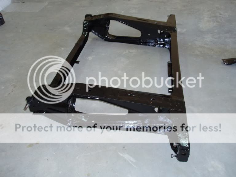

I've just done my front & rear subframes with POR15.
I dont think the sun will get to too much under the car.
The outside section of the rear subframe I gave a coat of POR15 Blackcote.
[img]http://i380.photobucket.com/albums/oo244/cdavies_photo/frontsubframe2.jpg
[/img]
