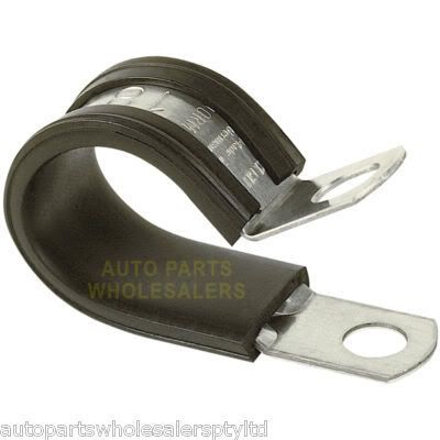

i no longer haver the clips that hold these items under the floor iether as all the other panels have been replaced..so i was going to use these clips.
.they come in differet sizes so i should be able to get ones to hold the brake line ,fule line and power cable.

we used those clips on our competition car, worked a treat

I recently redid my fuel line using 5/16 bundy steel line (2 meters) and that style of clip. works fine and is nice and neat, I was very happy with it :D .
