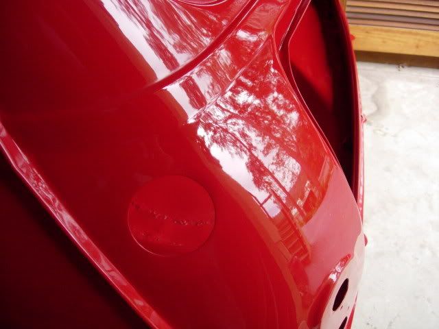

this was my little beaut back when we first finished her. i remeber being over the moon and no real issues since either just take the time and it will be well worth your while
Enjoy Chris ;)

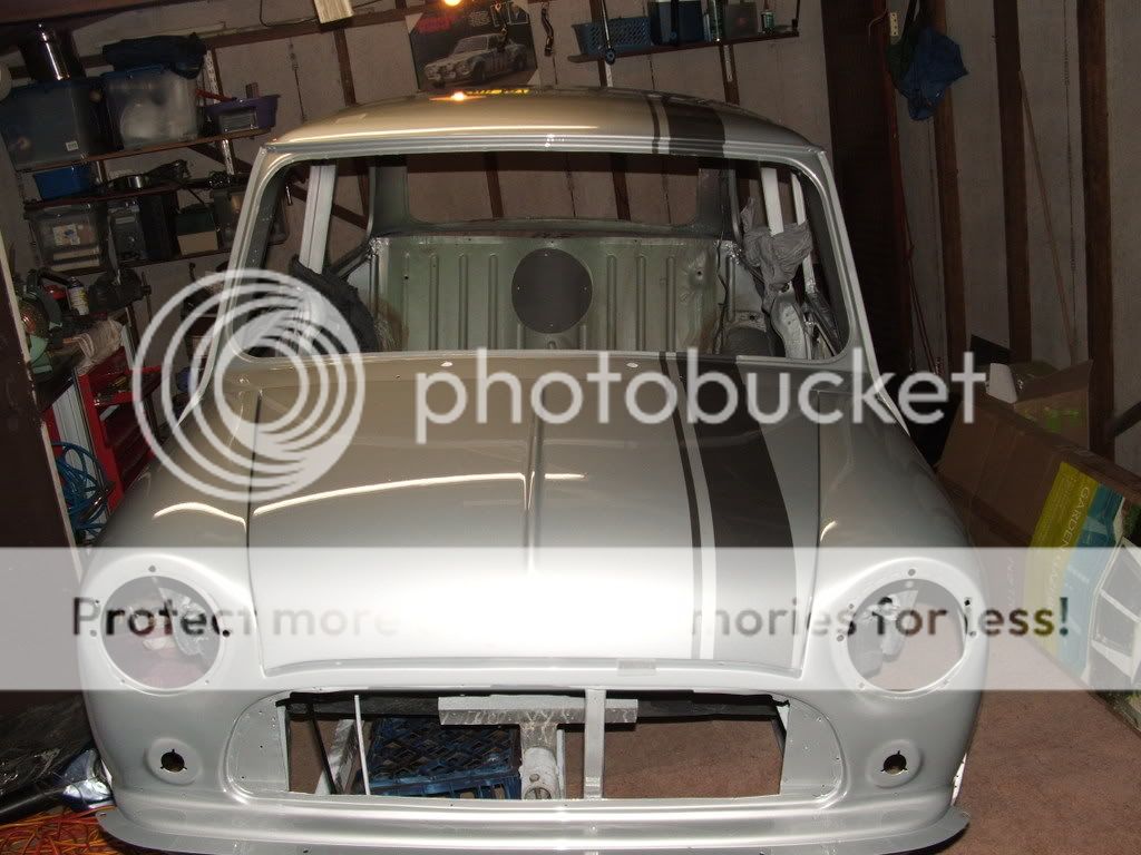

Driveway spray job. Lots of time on the body prep etc.
This is in acrylic. Decided that mini will live indoors, out of sun etc. Tartan red body with a metallic silver roof and stripes. Maybe not as good as a body shop but OK - maybe a 7/10.
The final result will only look as good as the preparation under the paint. Take your time. Acrylic is good and can be fixed and improved. If I had the correct booth (or the money to pay someone who has) I would certainly go the 2 pac route.
