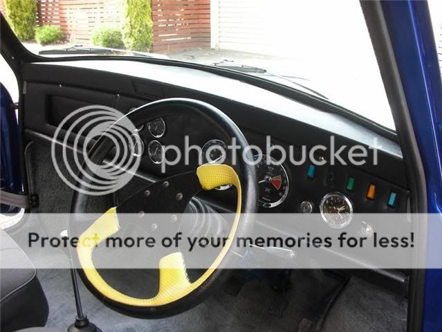

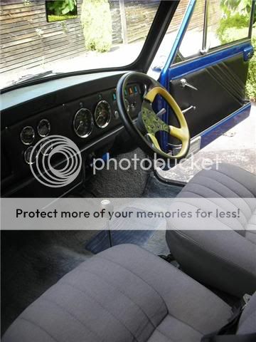

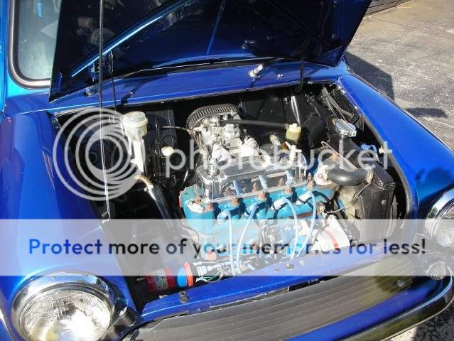

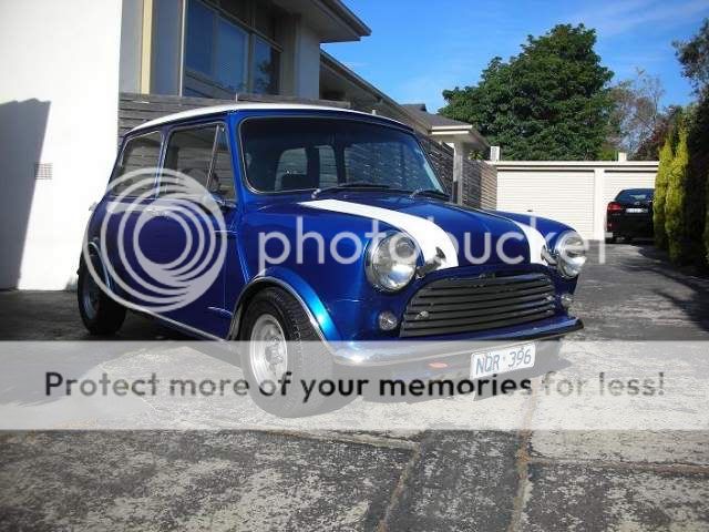

here are the photos ive got of the dash, engine and front bonnet

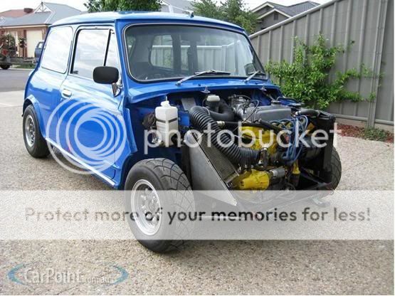

i Believe from what the owner tells me you can take the front bodywork of to make it easy to work on the engine like the picture of the light blue car Below (not the same car)

inner guards are needed to build up under bonnet air pressure, this pushes out air through the only outlet, the radiator. :)

Not sure on the legallity of inner guards missing (though as mentioned they are advisable to keep) but I would be checking that it has been engineered for having the removable front guards/bonnet . The front panel of a mini is structural and will need engineer's certificate to show the subframe has been braced to the remaining bodywork to the same strength as the oringal panels did (if you can understand that) .

I'm confused, the first car has open bonnet, not flip front, so what is the chatter about missing inner guards? Nice looking car BTW, like the blue/white, and some bling under the bonnet!

Molly moke, it says that the bottom car is not the same car. And if you look closely at the engine shot you can see that the inner guards are missing.

the first car can also have its front removed like that one, so it has no inner guards.
