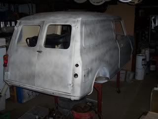

My van shell is sitting on a trolley with height adjustable legs. The trolley is the size of the floorpan (935x1350 with 500mm long legs) It's made out off 2 inch box section and has a caster wheel on the bottom of each leg (2 have brakes).
