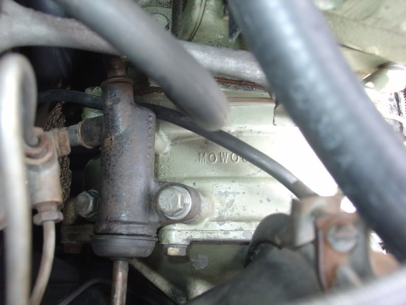

Thought I would take some pics of my 9FSAY engine in case that helps at all. This is the original engine in my 68/69 S. I can't guarantee someone hasn't changed the cover but I doubt they would. Cheers.

What size idler gear bearings do you have? The later MK1 cars use the larger size idler gear bearings as per the 4 synchro boxes. IIRC the early cars used 1" O/D bearings with the equal length idler gear shaft. Later MK1 cars used the 1 1/16" O/D bearings with the unequal length idler gear shaft. Housings for each are different externally.
The 1 1/16" bearings go with the 22A1288 commonised 3 synchro gear box case.
Flute's pic shows the later type. It has a depressed section around the middle of the flywheel housing. This should have 1 1/16" O/D idler bearings.
Around this time they also came with the boss for the breather for non S 1275 blocks.
IIRC my 66 S didn't have the depression. It was just flat and had the 1"O/D bearings. (Well it was 40 + years ago)

Mine may be the later type but it is a three synchro box. I have the chrome stick too.

My late 68 build MK1 S has the flywheel housing with the breather boss (undrilled of course) and the 3 synchro box using the 22A1288 casing.
Looking at your pic is your starter solenoid mounted correctly? I've had mine off several times and I've allways had it with the terminals at the top.
Not being critical, just curious, as I can't remember how it was originally.

From what I can see in the photo I would guess the clutch housing to be around 1967 and the cover to be 1968 69
