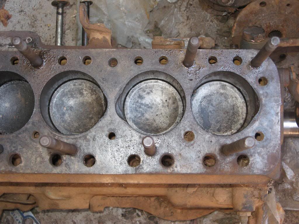

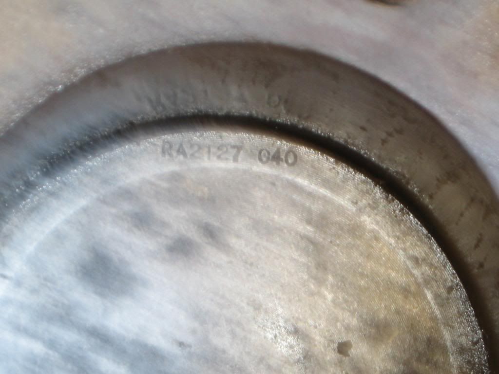

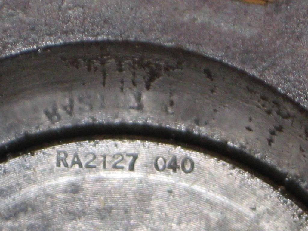

i was given an engine and are at the stage of pulling it down and replacing the rings and bearings and came accross these on each piston has it been bored out 40thou?? oh and my brother believes that it has been pocketed
here are some pics
damian
PostPosted: Sat Jan 03, 2009 1:09 pm
Yes it has been bored 40 thou oversized and yes it has also been pocketed (the little round cuts on top of the block) to allow a big valve or 1275 head to be used on it . It's a 998 isn't it ?

no its an 1100 and i thought that it has been pocketed to fita 1275 head just making sure :wink:
PostPosted: Sat Jan 03, 2009 1:23 pm
Yes , I should have said 998/1098 meqaning not 1275 , having the block pocketed like that gives the 1275 valves room to move without striking the top of the block and costing money ....
PostPosted: Sat Jan 03, 2009 2:33 pm
Posts: 39755
Pretty rough pocketing job it looks like, particularly #3- I'd redo them... just trace around a 998/1098 gasket. :wink:
