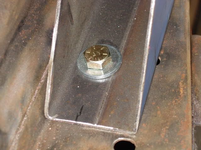

adnams4ever wrote:
Thanks miniDave,
Looks fairly simple to build. How do you hold the Mini in place when you turn it etc?
quote]
After these photos were taken I put holes through each bracket on the body (of the blue square) then a hole through the pipe running down the centre to lock it level, lock it sideways and lock it upside down. Used piece of 10mm rod to lock into the holes.
Dave K.
