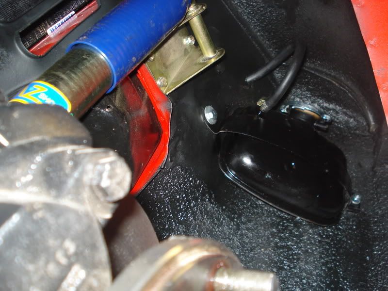

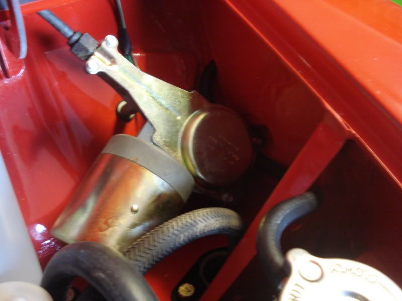

Cos I just did this job this afternoon, you get lucky and can have a few photos of how I set mine up. It's a brass tank from a Morris 1100 or Moke (I can't remember which) which I have fitted under the passenger guard. The bolts sit hard up against the underside of the internal parcel tray so are not visible without a good forage beneath the dash.
BMC were kind enough to provide a hole at the rear of the inner wing precisely the correct size to allow a 1/4 ID fuel hose to pass through, it's like they read my mind :)
With everything else in the cooling system being new or refurbished(the radiator) and a 74 degrees C thermostat, I'm guessing I won't have any problems in the heat.

Certainly not my choice of place for it..... How do you intend to look in it to see what level it is at??

Not a problem although a little fiddly. I use my finger to feel the level, it's not as far up the guard as the picture might make it look..
I've simply filled it at times and let it find it's own happiness by expelling unwanted fluid.
My last Cooper spent a long time in the NT using this setup, and it's the least clutter out of the options.
