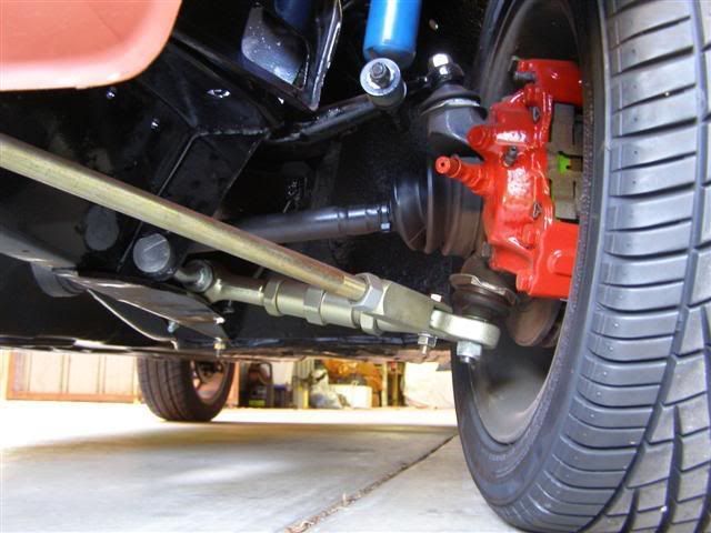

I have grp 5's and I also have 13x7. The rears sit in ok with no spacer on the drums, but the fronts poke out about 10mm. I have got adjustable lower arms so I reakon I will just crank the camber to get them inside on the fronts.. as I have to go for an engine no. check and they will defect me if there is something really obvious.

I think thats the reason mine a boarder line (well less wrong).
So my pic would be an example of this mod?
