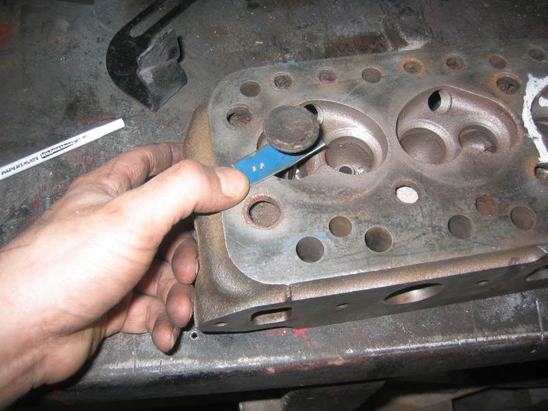

does anybody know what page the de-shrouding template is in david vizards book "how to modify your mini" i copied one onto transparent film and cut it out but doesnt seem to fit. and it said it was for all 850, 998, 1100 small bores :? . anyway the head is stocko off a 998 clubby.

I made this little thing, it slips over the valve stem (snuggly) It has two small holes in it, one for the ex and one for the intake.
