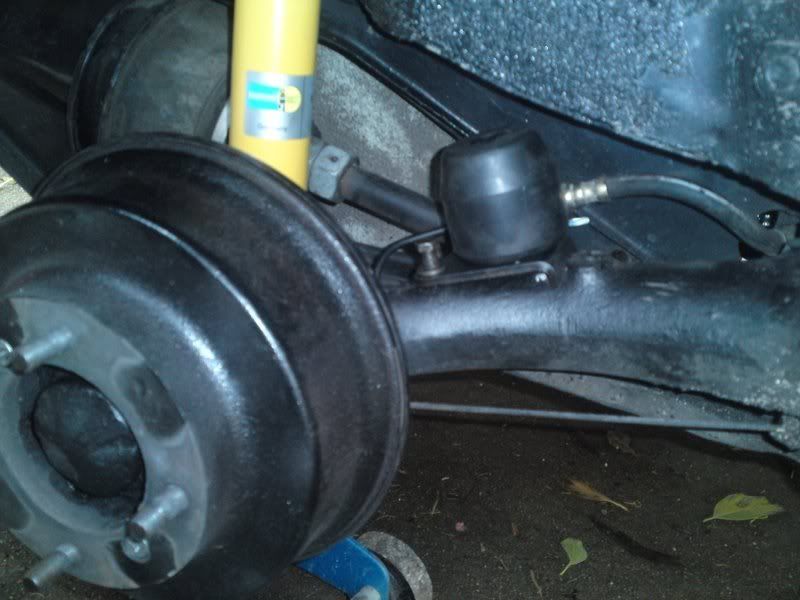

I have put new competition bump stops on the rear arms of my hydro 65 Deluxe. The sheet in the packet says that there needs to be a modification on the body seam so that "the bump stop must sit flat when compressed".
Is this true? Does it mean I have to get out the grinder and get into the seam? Could be I have bolted it in the wrong position!
Photo below is where the bump stop hits the body seam.
Regards
Dave K.
PostPosted: Tue Jan 20, 2009 10:32 am
You have to grab a pair of vice grips and bend the seam out (don't cut it.) otherwise after a few corners you will split the rubber in half as the body cuts into it.
<edit> just looked again and you're running hydro so you don't need to make any modification, it only applies when retrofitting to dry cars. Unless you have converted it to hydro.

PostPosted: Tue Jan 20, 2009 10:35 am
Posts: 18888
You might be able to fold it by persuading it with a soft hammer. The seam cuts into the bump stop over time depending on how much load is placed on it.
I haven't folded mine as they are pretty cheaply replaced anyway, I didn't like the thought of taking a hammer to the body work after so much work.
PostPosted: Tue Jan 20, 2009 11:07 am
I bent mine (hydro) just a little bit with some pliers - I had them out again recently and they haven't been hitting the seam
PostPosted: Tue Jan 20, 2009 6:47 pm
Posts: 39764
You have to bend this seam out about 45deg regardless whether it's dry or hydro.
But with hydro you don't need to drill and tap the arms or move the brake pipes.

PostPosted: Wed Jan 21, 2009 8:18 am
Posts: 728
:idea:
miniDave,
I think you have them on the wrong side. The body seam is directly over the middle of the stop. If you swap them between L and R it will move the rubber bit more towards the centre of the car. You may find that you don't have to bend the seam at all. I didn't have to do this at all on my S.
Hope this helps
RonR
PostPosted: Wed Jan 21, 2009 8:31 am
They should only go on one way otherwise they wont be square.

Posts: 728
Bit more info.
The angled cutoff corner goes to the inside of the arm. Just checked mine to make sure.
This is a very obscure way of saying - you will have to modify the body of your car so the bump stops won't be cut into half in use! I hate the way instructions like that gloss over facts like this.
On mine I just cut the sharp excess hanging down and filed it smooth - took about an hour to do it properly.

miniron wrote:
:idea:
miniDave,
Hope this helps
RonR
Ok and thanks for that. I will swap them over and see what happens.
Dave K.
PostPosted: Wed Jan 21, 2009 9:05 pm
Posts: 39764
Yep they are on the wrong side. I did Mini Mad's ones, see his pic above near top of thread. :wink:
