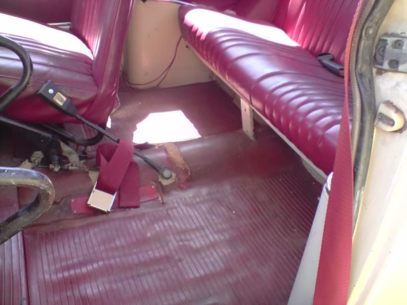

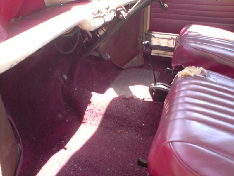

My Matic has rubber mats yes (a bit battered too from lugging drum kits in there!), but has a bit of fitted carpet in the front section.
these are the only pics I have at the moment but can try and take some more tomorrow in the daylight

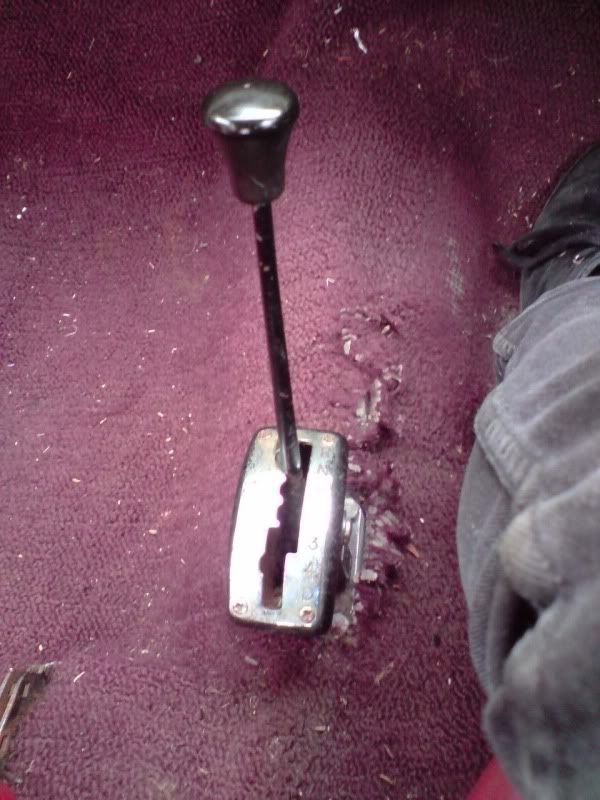

This image may help you out.

Thanks for the pictures. Mine did have the red vinyl but was in terrible condition when i got the car. Its getting the 9 piece carpet set.
Looking at the different photos, some bolted straight on top, some had the flooring slipped over the top so the silver housing isnt visible. I might look at doing the latter so the cable and the bottom housing are out of sight.
