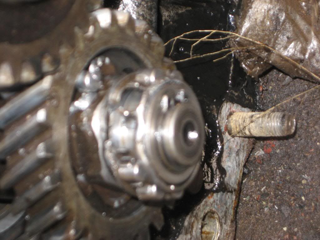

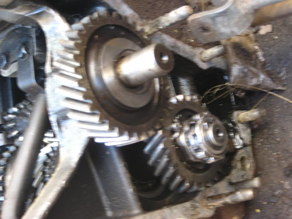

my brother and i pulled my engine down and could someone tell me what the name of this bearing is called as it needs replacing....first picture ia where it is located and second is the bearing

That would be:
http://www.minisport.com.au/prod448.htm

out rigger

you'll need to remove the outer race from the housing - put a bolt through a large washer and weld it in place, weld the washer to the outer race, then put something big over the top, and screw a nut onto the bolt to pull it out

two big screw drivers to lever it up a little, then a bearing puller to take it the rest of the way. Simple. :wink:

:idea: first pull out the circlip that holds the outter bearing race in or you will be there for a while :!: :lol: 8)

The outer bearing cone can also be removed easily by running a weld on the inner face with an arc welder which causes it to shrink and it will fallout easy.
