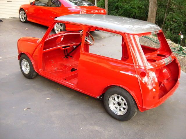

There can be a difference between under body sealer and stone chip. The CAM stuff I use is a sealer which usually stays black and can't be painted over. The Anti-stone chip looks similar but can be over painted. I have only used the CAM brand so maybe there are others. I believe that there was some sort of sealer surface under the new cars. This is mine on the underbody and wheel arches. Boot is body colour with no sealer.
If you are having a paint shop do the job with all the good gear then I would go 2 pak. I painted mine at home in the driveway and used acrylic.
