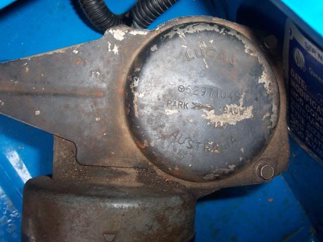

This is the wiper motor I have;

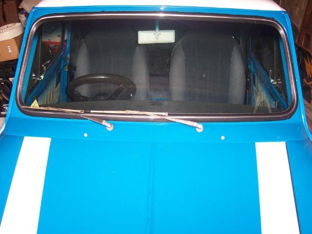

The car is a 62/63 Morris 850 witch parks on the left;
The numbers on the wiper motor;
62971045
PARK >>>---> 12AUW

Do you mean the side their on in the picture? because that's the side they've always parked on and their single speed non-self parking ie I have to turn the switch off where I want them to stay :wink: .

Kennomini wrote:
John Smidt wrote:
I think You will find that your wipers will park to the left when you get the motor going
Do you mean the side their on in the picture? because that's the side they've always parked on and their single speed non-self parking ie I have to turn the switch off where I want them to stay :wink: .quote]
They will Park on the opposite side to where they are in the photo,
In the photo they are parked to the left when looking at the photo, However they are parked to the right hand side of the car
PostPosted: Sun Feb 15, 2009 8:44 am
Posts: 39757
John if you turn the crank plate around by 180 deg in the gear and refit, will it not just park on the other (ie driver's) side? One of these 2 speed motors I have here has park <<< on it... 8)
One other point with putting this motor in an early car- if you don't swap the early wheelboxes for late ones, the wipers will wipe 180deg... like Barney's did.
Kev I have not tried what you suggest so I am not sure,, There are some round dody wiper motors with the park direction indicated to the left hand side of the car, I mentioned the park side because the wiper fitted to this car has the park direction indicated to the Left.
