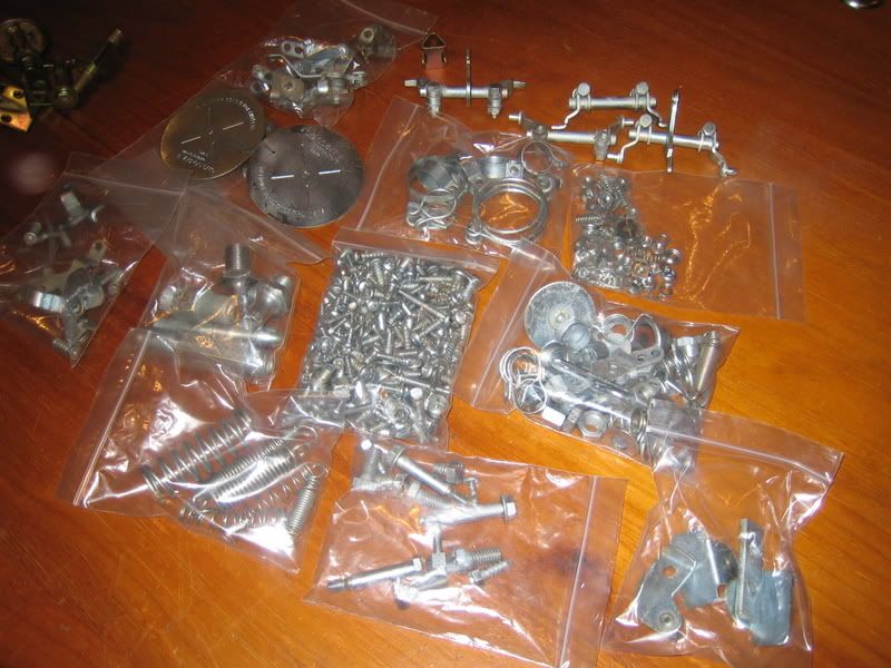

Here's some motivation...
Zinc plating will be the Jesus stick on your parts however...if some are worn a little thin with age then they will come back with holes in them. Think carefully about your more uncommon stuff, like Cooper parts, tin brake cylinders etc. If they're a little marginal, think twice about putting them in.
You can see in the third photo that a lot of bolts have severe pitting, this is not the usual case when zinc plating. They were especially marginal as they came from some pretty rusty components and so were turfed to the very last last resort bucket.
