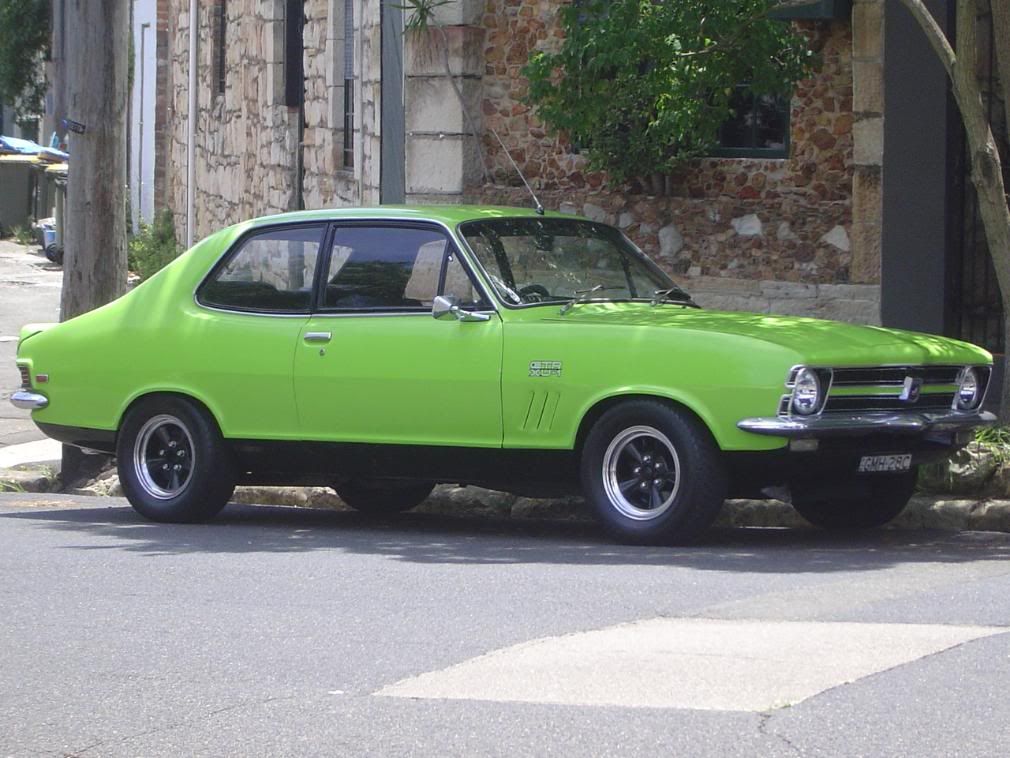

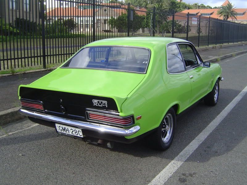

Go for 2 pac.
Both these cars are 2 pac
The Torana has been cut and polished to look like acrylic
Easy if you prefer the look of that finish.
