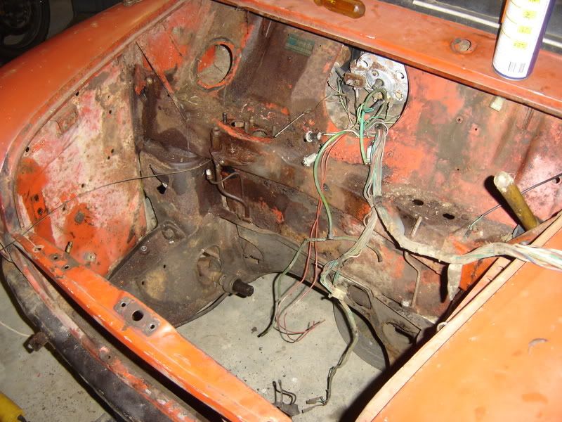

PostPosted: Sun Mar 01, 2009 10:35 am
Posts: 7339
Just had Panthersteve around and he pointed out the correct location for an early 850 like mine is up on the triangle brace in front of the hole in the firewall. - you can just see one of the mounting holes in the above photo, the other is just above it on the edge of the 'wet' patch.
