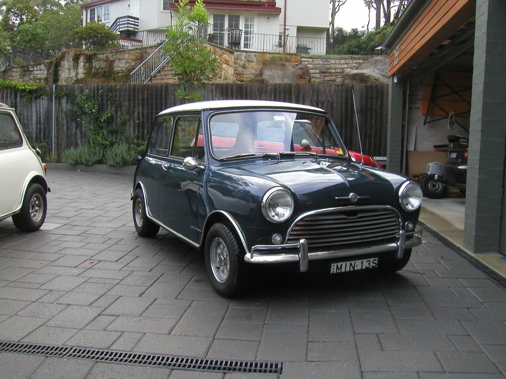

I have a mini deluxe which has been respayed in a dark blue which I thought was "Indigo Blue" but when I had some paint mixed it is the wrong colour. :(
Are there any other dark blue colours which were used by BMC in 1967/68 period?

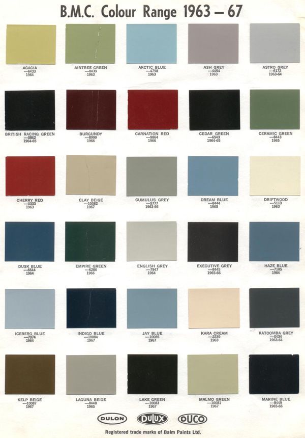

I have found a mini guide which has the following blues, but I can not remember what they all look like?
Marine Blue
"Indigo Blue" I thought this was the colour of my car but not quite right. My blue is darker and blacker.
Baltic Blue
Jay Blue -- I know this is very light blue.
Viareggio Blue

baltic blue is lighter, not sure about viareggio, but Indigo blue was always the darkest. Have a look on yours up under the dash etc. and see if you can find original paint - maybe someone just decided they wanted the colour that's on it, rather than the actual original...
it does have an indigo blue look about it, but... :?

Marine Blue looks a bit like it.

looks pretty close to marine blue to me. our cooper had been sprayed marine bue when we got it. its a 66 colour i think.

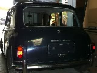

mine is marine blue

What colour is the roof?
Toga White?

I agree it looks like marine blue, I've got a door of my car that's still in the original paint and it's quite similar to your cars colour.

It looks to be the same colour as Big Dogs car. And believe his is Marine blue.

thanks and correct

Dulux code for Marine Blue is 8449 or 08449
Berger code for Marine blue is 5931.
The Dulux code should be the one that works. :wink:
