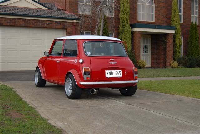

Mine is all 2 1/4 stainless and sounds fantastic with nice little cannon on the end and thats all....
:lol: :lol: :lol: :lol:

Nope you stuffed up your link, it's got an extra [img]at%20the%20end,%20and%20a[/img] at the beginning

In my opinion, cannons look fugly.
I'm with tiny on this one. 1 3/4 inch with a nice RC40 or similar is what I would go for.
