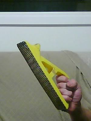

Another thing to try is a Wrasp (rasp). You can get cheap ones from bunning for about $20 or something. Its like a file, but it won't load up. Get your shap with this then finish with 120 and 240.
<EDIT> Trying to load photo opf wrasp to photobucket... be back in a sec
PostPosted: Thu Jul 01, 2010 7:53 pm
Posts: 1550
Here's a wrasp (rasp... however you bloody spell it :P)
Its a good substitute for a body file and considerably cheaper.

using a random orbitol sander smashes it heaps quick as well!
Isnt a wrasp/rasp file also called a cheese file, or is that something different?
Nope same thing, cheese file, wrasp/rasp whatever you want to call it... Surform I think they are called too sometimes...
