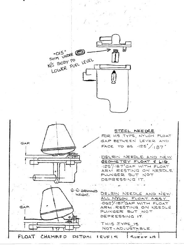

the float is a set level you cannot adjust it.

PostPosted: Mon Mar 23, 2009 9:40 pm
Posts: 6844
Location: Cairns, Nrth QLD
Plastic float? Yes you can adjust it sort of with a shim. Info supplied by Midel.
