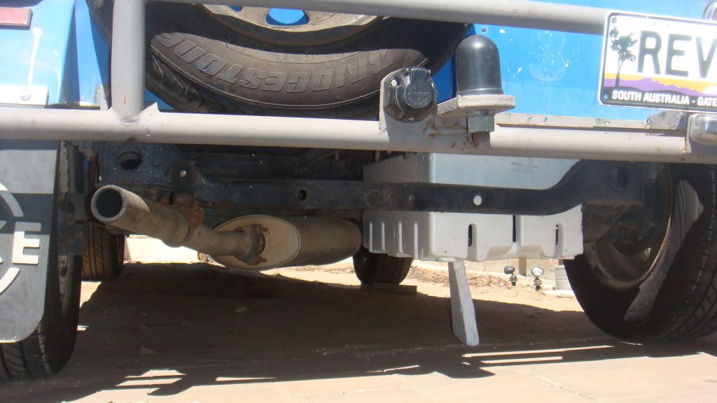

So I went looking for a new tank in a local boaties shop, they have a 25L stainless steel one that looks nearly good.
It measures 300 wide (still plenty of room for the exhaust), 460 long and 220 deep, and only $189.00. I have been looking at plastic ones that are a bit too big on Fee-bay for simlar $.

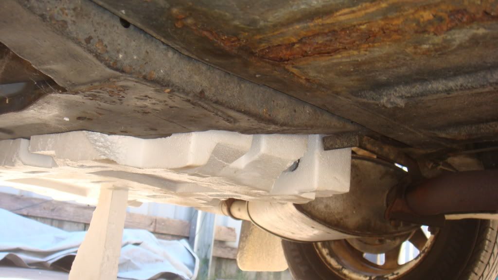

So I was a bit worried as I had measured a maximum depth of 200 mm so it wouldn't hang down too much, so I cut a foam box to the same size (the tank had rounded corners left and right, but flat sides front and rear), so I expect it will fit a bit better, but here is my foam tank showing the maximum amount of hang:
And from the front (nice rust huh!?):
I figure if I make a cover from the front to the rear of the subframe, that will hold it up (it has no mounts) and offer it some protection from rocks etc.
The filler neck will be behind the rear seat space, in a fixed tool box, it has a vented cap so it will need to be as high as the side tank breather, the fuel line will go up through the floor, then back down and forward.
Suggestions or warnings welcome!

PostPosted: Sat Mar 28, 2009 3:00 pm
Talk to an engineer to be on the safe side :wink:

Definitely go with the Spridget one, or if going custom make sure you get an engineer to sign off on it, this is one thing you don't want to get wrong...
