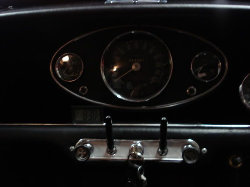

PostPosted: Sun Mar 29, 2009 3:46 pm
I found my temp gauge buried in a drawer, so dug it out and refitted it to my mini. It sits by itself right where you see it in the photo atm. The lead passes throgh the small gap beneath this point and then joins the wiring loom to get into the engine bay. It comes with a 2.9 meter soft flexible lead. Nice and discrete. It measures accurately to 0.1 of a degree and with a range of -25 to 150 degrees C. It also has a minumum and maximum temp memory as well as well as an alarm if it goes outside these temperatures.

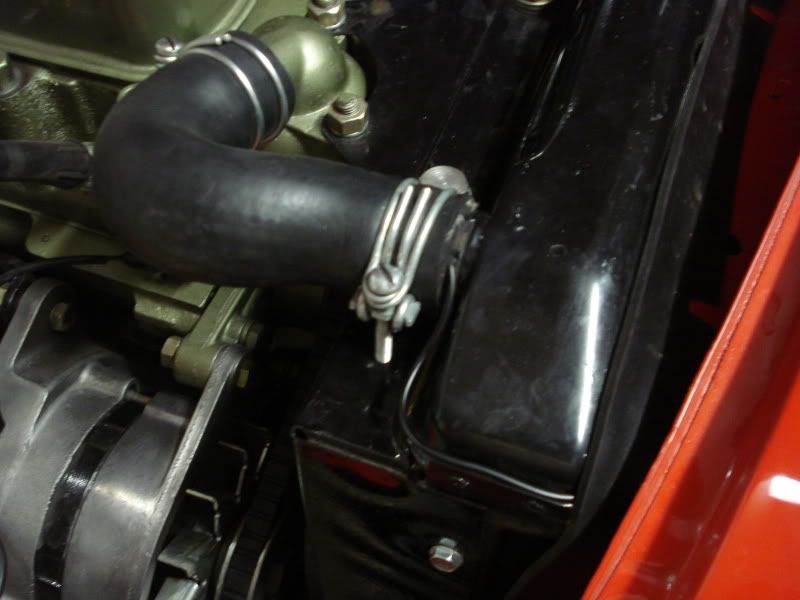

It slips under the top hose nicely, but I had to create a small gasket to get a good seal. To do this got a small piece of 20 x 10 x 2.55 mm rubber and made a shallow groove down the middle. I then I champhered the edges and put that between the cable and the radiator inlet pipe.
As described elsewhere, the probe will slip with a machine fit into the oil cooler matrix if you want to keep and eye on what is going on there. So depending on what blows wind up your skirt, you can watch inlet or outlet temps. There is an error of a couple of about 4 degrees at full temperature and driving because of it's external placement when you place it in the oil cooler matrix, but it goves a pretty good indication. This reduces to zero when you stop at the lights.
If you want a more professional finish, you could have a 18th brass olive brazed onto the rad or the cooler. all you need to do then is slip the needle probe into the fitting as far as is needed to put the tip into the flow, and tighten. These are good for a couple of hundred PSI so would be more than enough.
