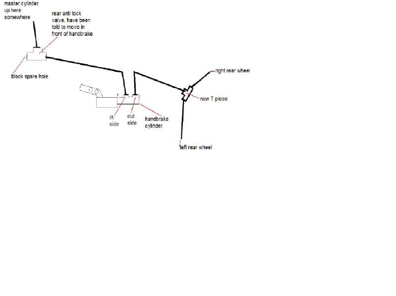

hey guys, im ready t run my hydraulic handbrake lines, i just want to make sure i do it right!
big thanks to julie (kyoda) for the tips and photos she gave me.
here is a diagram of how i think its meant to be set up, :
its a quick paint diagram.
i have tried search function but only found dodgey posts!
-jamie-

and pick looks right, just make sure you have correct size WC

what do you mean by correct size wc?

If you have a 3/4" handbrake, you need to have smaller Wheel Cylinders
I found the ones from a Morris Minor More or Less fit, they are 7/16"
The Smallest ones are 5/8" available for MINI but for ultimate lock up POWA i use the Minor ones

I kept the standard proportioning valve in situ, and simply put the handbrake downstream of it... no need to move it, just add a T piece on the rear subframe.

thanks simon, i was planning something along those lines, it was just easier to draw the way i did!

I'm sure you've been told to replace the flexible lines at the back if you haven't already
also, the prop valve uses different flares (single flare) to the normal T piece off the firewall (double flare) - so either get a couple of new lines made to go from the new T piece to the flexible lines (as I did, also meant I had some extra length which was handy), or find a single flare T piece

yes simon everything will be replaced new hoses are on already, thanks for the tip about the lines
