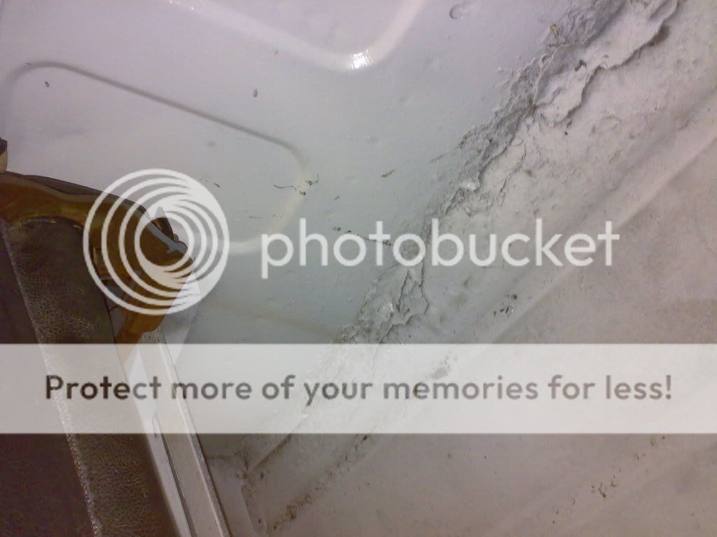

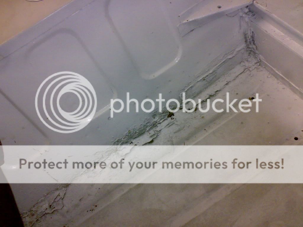

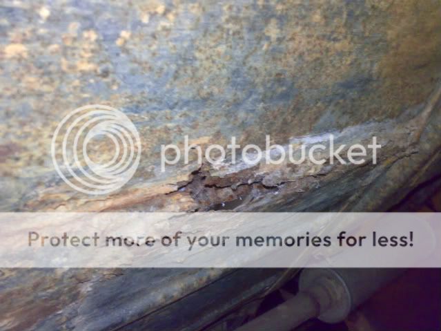

ok so i got myself a moke.
Its got rust in the floor on the right hand side of the front seat and im wondering whats the best wayof going about removing it, should i go ahead and cut the whole lets say a meter long strip of about 10cm up the side and 10cm across the floor and get a strip of metal welded in or is the something in not concidering here?? also has anyone got any idea what its gonna cost me if i get a shop to do it if i cant?

ok here some pics
http://i616.photobucket.com/albums/tt24 ... 009514.jpg
http://i616.photobucket.com/albums/tt24 ... 009513.jpg
http://i616.photobucket.com/albums/tt24 ... 009512.jpg
http://i616.photobucket.com/albums/tt24 ... 009511.jpg

kudos to minis wrote:
ok here some pics
PostPosted: Mon May 04, 2009 9:36 pm
Posts: 11749
Thats worse than it looks. What does inside the side boxes look like.

its just started 2 eat into the battery box but the other boxes are fineish the front box has a tiny hole but it aint bad
