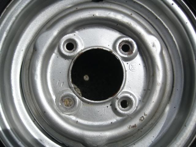

I can remember reading somewhere about early mini wheels breaking on the race track and BMC (or someone else) releasing stronger wheels for them which were stamped with something . I saw the below photo's in bmacpiper's thread on his cooper s spare wheeel and was wondering if anyone knows the full story on the stronger wheels and if either of them are the ones . I'm not interested in the wheels by the way , just want to get the info right as to what was stamped on them .

as far as i can gather they were stamped M G R A C

It's interesting that the first wheel photographed has 888 with a Dunlop logo - I haven't seen a wheel with that number before. I knew Dunlop made the Cooper S wheels which were stamped LP883 for the 4.5 inch version, and other LP numbers for the reverse rim and other widths (I have some of the numbers somewhere in my files).
So did Dunlop manufacture all steel Mini wheels? Does anyone have a complete list of numbers and wheels?
