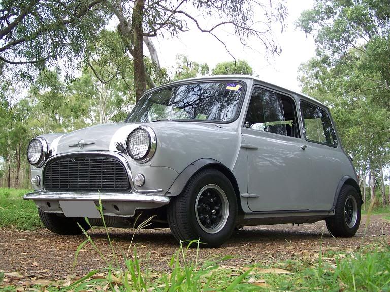

Being a noob to Mini's, my current 850 has flares, but what size wheels can i fit under them without scrubing and looking out of place to the police.
I like the look of the 10x7 ]http://www.tempetyres.com.au/products_closeup.asp?part=&part_no=1934 or http://www.ausmini.com/forums/viewtopic.php?t=51369
and 13x7 ultralites but not sure if they fit without mods. Currently i have stepped finned drums and S Disc' upfront.
Below is a pic of the car in its current state...thanks for all help in advance

Before you get too excited about the Tempe tyres 10 X 7 have a read through here so you know what to ask them before buying , http://www.ausmini.com/forums/viewtopic.php?t=52408 The last lot of 10" tyres that were availible in Aust were only meant to be used on golf karts or similar and weren't rated for highway loads or speeds . I asked Tempe Tyres about the speed and load rating's of these tyres and they said they would get back to me , that was about a month ago .
No real need to go over 5" wide anyway and they'll sit nicely under your flares with a 165 wide tyre .

& will put your track WAY over legal... If you are after something that is gonna be road legal, even some 10/12 X 6's are deemed not roadworthy - it all depends on the offset.

I reckon it looks great just as it is- same wheels, tyres, flares and offset as mine, LOL.
It won't handle as well with golf cart tyres and 10x7s, or with 7x13s wheels IMO.
And you will become a moving cop magnet..... :lol:
