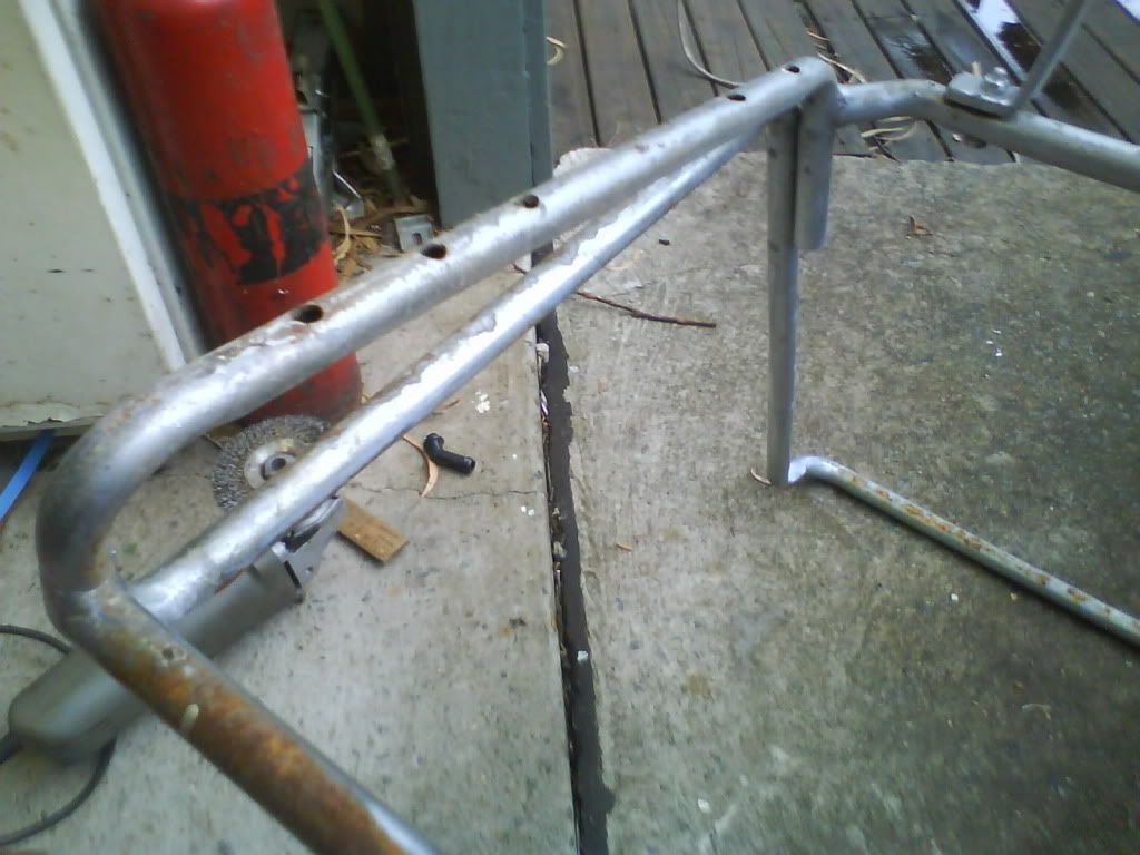

std drums mate,
pics of seat frames are you after?
PostPosted: Wed May 20, 2009 3:10 pm
Milatsmadmini
Posts: 6287
http://cgi.ebay.com.au/MINI-MOKE-SEAT-FRAME_W0QQitemZ140320728045QQcmdZViewItemQQptZAU_Car_Parts_Accessories?hash=item140320728045&_trksid=p3286.c0.m14&_trkparms=66%3A2%7C65%3A1%7C39%3A1%7C240%3A1318%7C301%3A1%7C293%3A1%7C294%3A50
thats them. it should have a slight bend backwards at the top to suit the original viynl covers, but if your gonna make some yourself...
EDIT
you can see at the bottom of the picture what i mean...
