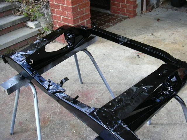

POR15. Did mine, they came up a treat. Tough & easy to apply by brush or spray. I brushed mine as I'm not bothered about any brush marks and you can get it into the narrow cavities quite well.
Others will recommend alternatives, like powder coating as above, but POR15 you can do at home and get a great result. If you're doing a concours resto, powder coating may be more suitable. Not sure if you can successfully touch it up though.

My experiences? It was expensive and takes a week to get off your skin (really, seriously, don't screw around with this stuff). It did the job nicely and is as hard as diamond.
Normal chassis black and epoxy paint will go dull and fall away in a few years so if you paint you should consider a high quality product like this.
I powder coated everything last time I restored a car (cost 300 for everything including subframes all at once in a big hit in satin black), this time I POR15'd to see how it would come out.
Powder coating is a great idea, I think I would powder coat again next time as once you add up the costs (86 dollars for chassis black, 30 dollar supercheap paint gun (throw it away, don't even bother trying to clean it I say) the overspray issues in the yard, hassles with dust and waiting for it to dry, concerns with the neighbors reactions to the overspray, clean up, set up etc etc) I think I would pay a powder coater to provide a perfect finish and save myself the stress. After 12 years there was very little damage, and a sponge would make it look new again. This was in the Darwin tropics.
Brushing provides a medium to good finish as it self levels as it dries. Everything must be spotless of grease before you start or their will be big dramas. Prime if you can, I used normal etch primer, not the POR product and had no problems. POR does not like bare zinc, not at all. It will run away like water from it, and fall straight off if you get it to stick to it and dry.
