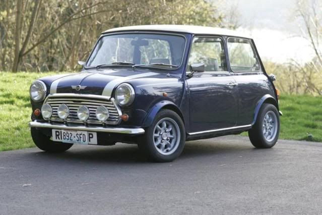

Never found a buyer for the '66 S, but had a fellow here in Seattle who has the time and money for the project, and he offered his '91 spec '76 (wink wink) in trade for the '66. Here's a photo of the new one in it's former and current lives:

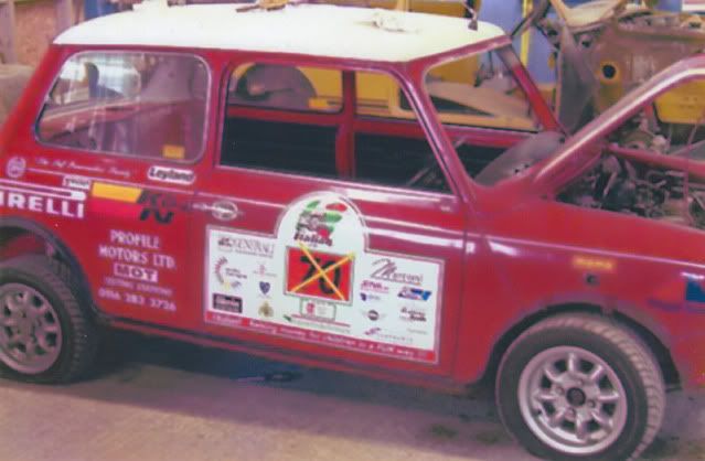

Here we go (any clues what racing circuit this would have been from?):

As much as it pained me to let go of the S, for the time being it was a good compromise on both sides--I got a nice running car with seatbelts for the kids, and he got the classic project. I'm glad to be close to him so that I can see the car come to life. I do plan to find another S down the road, and will be looking specifically for one from Australia. You have all been awesome and the worst part of the deal is that I don't know if my UK mini is welcome here, ha ha! I have sent the new owner to this site, and you may see him. His name is Mark, and he's from Newcastle, Washington.

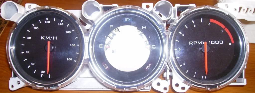

Sikaflex might be a good idea on the seam cover, but don't use silicone as it may eat the paint. If a diff change is too difficult, change the faces on the gauges.
For example:

If I change the faces, will that solve the problem? In other words, if the speedo is off by 10%, it's off different amounts across the speeds, and so not sure if the new face would take that into account?

You make a new face to suit where the needle points.
So all the markings are increased radially by ten percent each.

So there are faces available that do this, in other words. Yes?

You'd have to make the gauge yourself.
I couldn't tell you if there are different faces for different diffs, but it actually makes sense to me to do it that way.

Looks to me as if the car was stickered up for 'the Italian Job' Charity run each year to Trento in Italy, probably not raced as such.
The Cover trims should have metal clips holding then on, you can get a stainless version, or sikflex as was said above.

I would agree that it probably did an Italian Job...and possibly came from Leicester:
Profile Motors Ltd
Tel: (0116) 283 3726
1 Saffron Wy, Leicester, LE2 6UP
