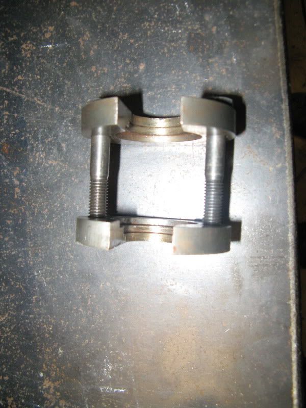

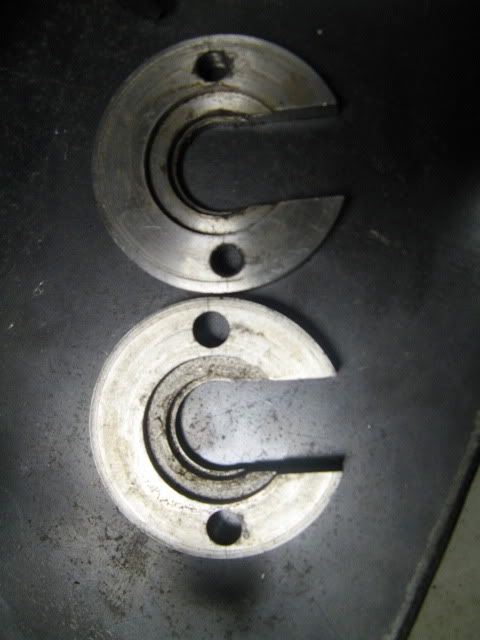

Hi you need one of these
They are a copy of the factory tool

I have one of these and have had it for over 30 years. It has done a lot of work. I bought it from a parts shop in London in 1978. It cost me one pound fifty I remember ! It is still going.

yep great tools
I went to evening class and made mine, as a could not find one to buy.
Its quite any easy job if you have a lathe
