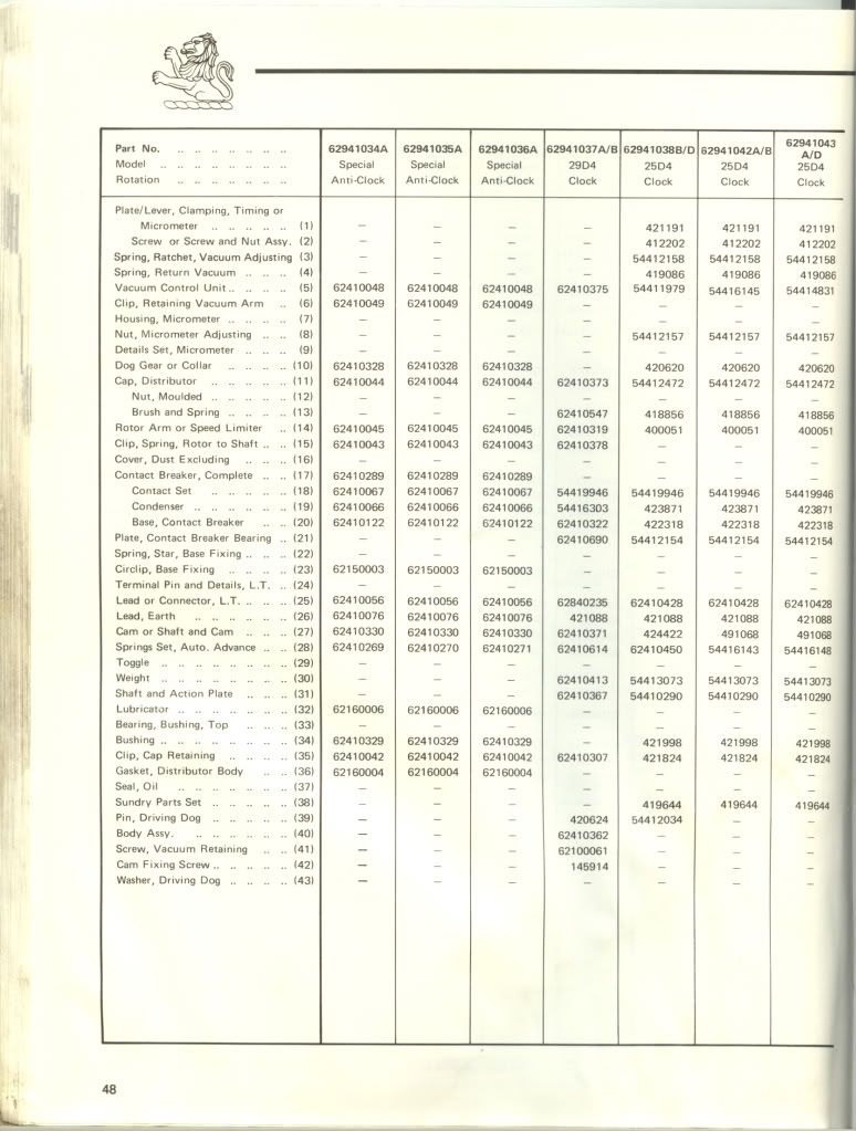

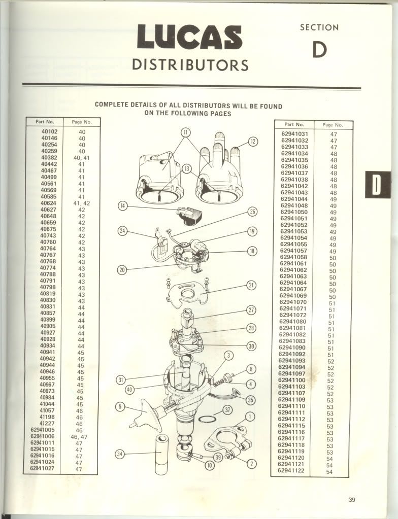

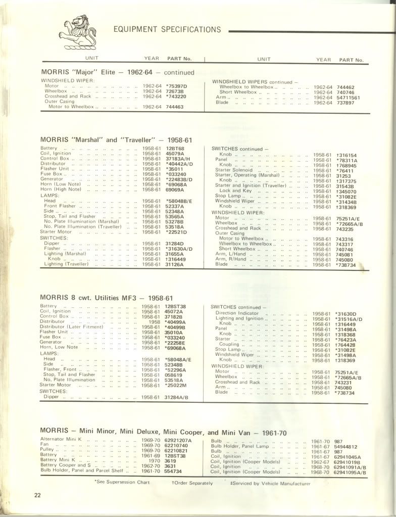

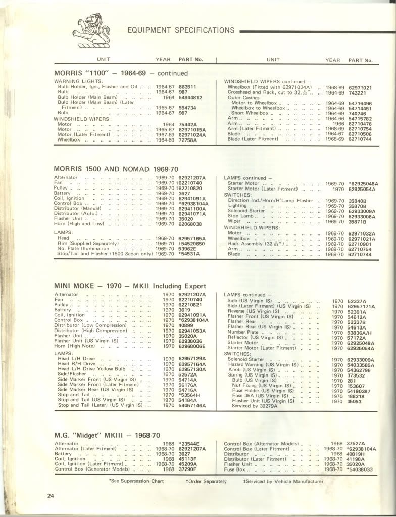

PostPosted: Tue Jun 30, 2009 1:14 pm
Posts: 6751
Relevant pages from the Lucas Australian Equipment Specifications. I've also included the Moke page, and the Morris 1100 page (mainly for Michael's benefit).
