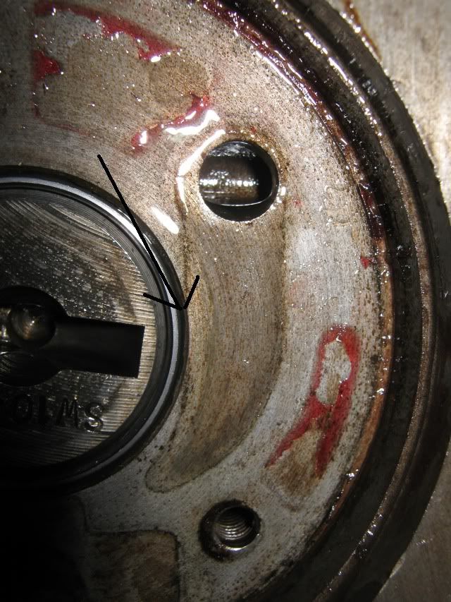

Should the cam bearing be flush with the block face between the oil pump and block? Because it is just inside to the motor a bit, and should there be a chamfered edged between the block and where the bearing starts, as in there it a gap between the block and bearing? All the other block I have at home are square to the bearing.
Would that be enough for it to loss its presser?

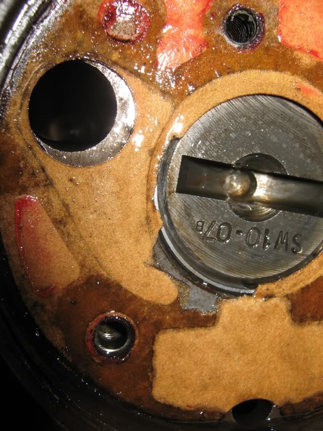

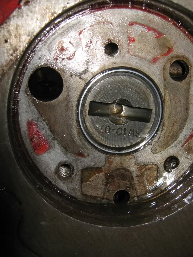

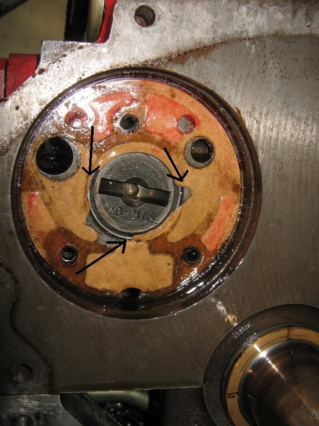

When we put it on the trailer in the rain, we had to drive it up. The 10 or so seconds of doing that make it lose pretty much all of the oil preasure. Also when we had no gauge on the oil line even at 10PSI the oil should flow out steady?
Here are some pics when you look at them the pump is just barely sealing agents the block, its more where the cam bearing is. I've broken the gaskit away in the pics to see how close it was it wasnt like that :oops:

Pretty lousy gasket sealing there, what brand is the pump?? (so I don't buy one) :lol:

Took the lay gear out of the gear box, centre oil pick up, cleaned it all, new gaskets back on the motor. We ended up making a aluminum shim to go behind the oil pump to seal over the cam bearing, a 1.6mm verson of the automatic to manual adaptor plate in case it was the partly to blame as well.

Thanks for the help the more question the better, what do we all think about this cam bearing not being flush with the block face between the oil pump and block? Would this make a differents?
