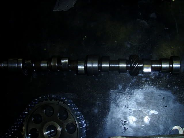

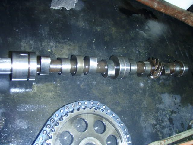

ok. i have totally no experience with cams and minis. learning as i go. My dads got a fair idea but doesnt know how to id it. i could show you a photo?
PostPosted: Thu Oct 22, 2009 11:14 pm
Posts: 1550
that would be great,
can you get one of the whole shaft side on and also of the end for the oil pump drive? I can pcik a few of the factory cams, but if I draw a blank I'm sure someone can help you here :D

PostPosted: Fri Oct 23, 2009 12:26 am
Posts: 1550
ok, it doesn't appear to be a factory cam... it looks like it might have been reground at some point just looking at the round profile of the noses but I could be wrong,, there doesn't appear to be any material removed from the base circle radius of the cam which is usually a give away that it has been reground (but not always)...
You might need to check the cam with a dial guage,, the easiest way I know of is to put it back in the block with the head off, and the timing gear and chain on, a push rod down the push rod hole on cyl no.1 on the intake and then on the exhaust, and a 360 degree protractor on the end of the crank..
I'd dearly love to tell you how I check them,,, but your thread will end up derailed for sure with a debate over the colour of the sky or something stupid.. If it starts looking dire I'll jump in and write up a how to on checking a cam,,, and then run like a mo fo to escape the burning wreckage!!
edit---> I can tell you that it is a spider drive oil pump,,, and a 1/2" lobe!! :lol:

Phat, don't sweat it! I'm reasonably sure that you would be able to describe it here.
Yes, I agree, it does not appear a factory cam. You can check it for yourself with a dial gauge and 360 degree protractor. It's not that difficult, but you cannot rush it either, so make sure you've a bit of time.
You may also be able to take it to some of the cam grinding comanies, Some of these will check it for you (and check for consistancy) and provide you a print out. They would most likely charge for that service, but I wouldn't think it to be much.
How did the car drive (assuming you drove it with this cam)? Do it perform / behave in a way the you liked? Is so, maybe just stick with it and not worry too much about particular numbers.
