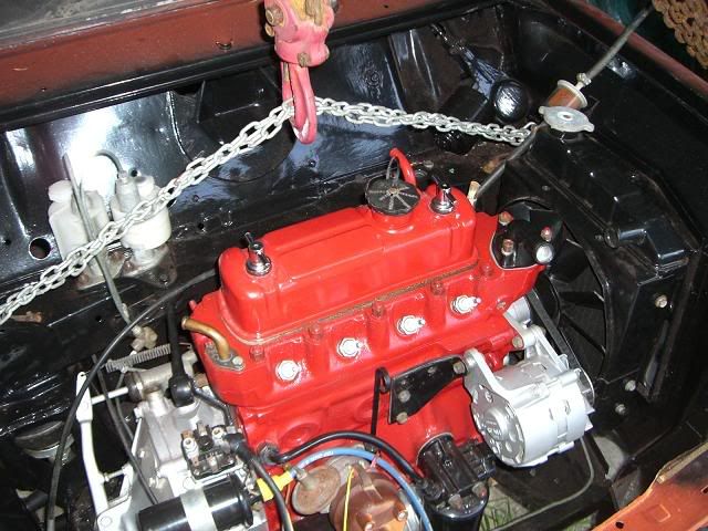

For some reason my oil filter is hitting the subframe, which is causing an oil leak at the gasket. Its the cartridge type filter, but is there any reason it would be doing this? Its got new engine mounts and engine steady bushes but it must be tilting too far backwards still?

well its only happened this time on reassembly (took out the engine and subframe to be painted - put back with new everything pretty much) and i never noticed it till oil was pissing out when i was cranking it over :x
hmm would it matter that the remote housing is only on finger tight? (ie really loose) that would tilt the engine forward fractionally?

If you have the later English Metro type oil filter head then they do stick out a lot further
can you show us a pic of your oil filter head???

heres the filter front on
and heres it on an angle hitting the subframe, not the best photo sorry
engine steady is now connected

sorry but i can`t see it hitting the frame,,, the pic just doesn`t quite show it properly
Is it hitting ,,, like constantly on the frame?... or just missing it by a little tiny bit? is there any gap at all???
